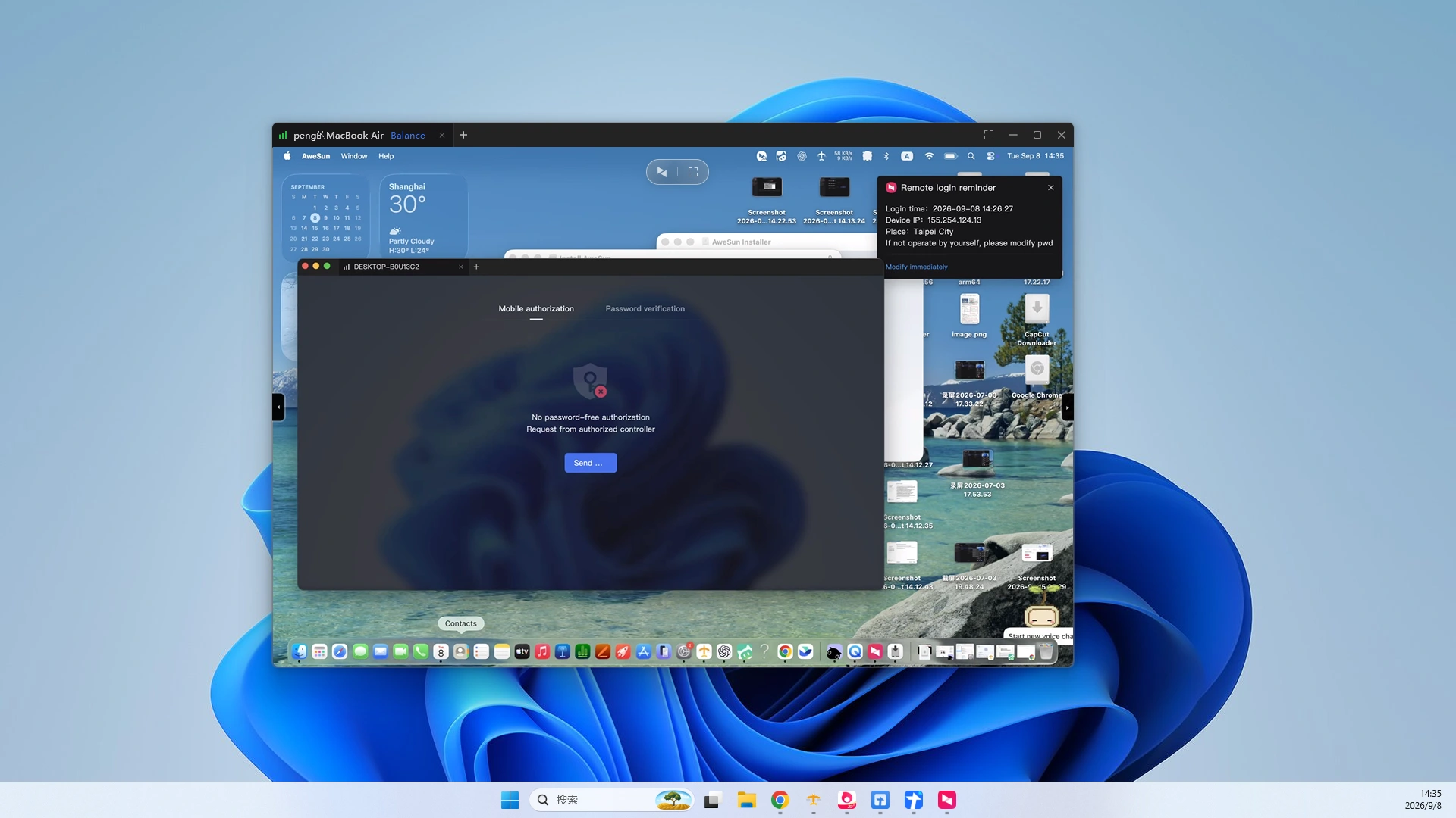

1.Download and install AweSun: Install the appropriate version on all the devices you wish to connect.
Awesun Remote Desktop
2.Log in and configure your devices: Follow the on-screen prompts to log in and authorize the remote computer.
rustdesk alternative
3.Start a remote session: Initiate a connection by selecting a device from your list or by entering the remote device ID as prompted. You can also set up "unattended access" in advance to ensure you can connect anytime, from anywhere.
